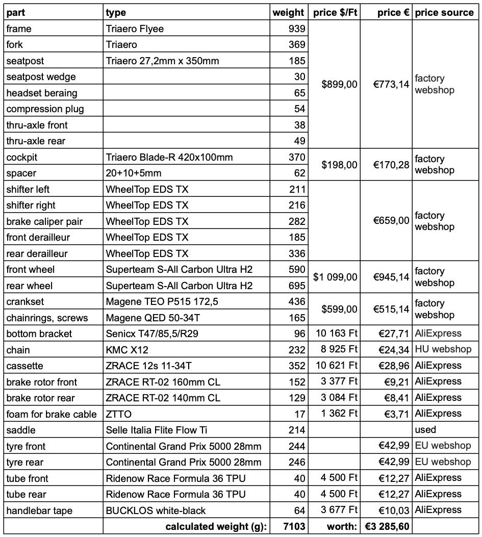

Where does this build stand in terms of weight?
As the parts kept arriving, I became increasingly curious about the final weight of the bike. I can report that we got quite close to the 6.8 kg UCI limit. Without pedals, measured component by component, the total came to 7,103 grams, while a complete build on a hook scale showed 7,175 grams. The difference is likely due to the inaccuracy of the scales, but being under 7.2 kg is still quite impressive.
Bike on the scale after building
For comparison, a road bike with a similar weight from well-known Western brands typically costs around €5,000–6,000, usually equipped with an Ultegra or Force groupset.
How much does a road bike like this cost?
This is maybe the most important question, and it’s not really black and white. With my list of parts this bike worth around 3300 €, which is around 60% of the price range of those bikes I talked about earlier. This is a really big difference, but build requires parts and knowledge which can be additional cost when you don’t have it.
But what do we actually get for our money? With a factory-built bike from a well-known Western brand, there is the prestige of the brand, a solid warranty background, and it’s also worth considering that such bikes are generally easier to sell on the second-hand market, often at a higher price, if you decide to upgrade later.

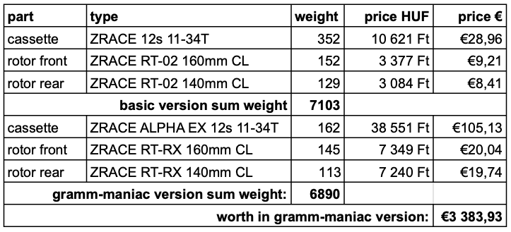

The paperlight ZRACE ALPHA EX cassette and rotors looks like SRAM Centerline XR
The cassette I originally bought is similar in weight to a 105-level model. The ALPHA EX, however, is surprisingly light: just 162 grams instead of 352. This is achieved by machining the smaller nine sprockets from a single piece of steel, while the largest three are made from a single piece of 7075 aluminium, with the two sections riveted together. The most surprising detail is that the interface with the freehub body is only supported at the two ends of the cassette. The sections in between are connected by a plastic spacer tube.
When it comes to rotors, weight is not the main priority. Alloy offers better heat dissipation, and its design also helps improve cooling through airflow. On top of that, I think it gives the bike a more professional look.
The Weight weenie option in numbers
The total difference is 213 grams, which adds around €100 to the cost of the bike. In return, the calculated total weight drops to just 6,890 grams. Even when adjusted, the measured weight still comes out at around 6.96 kg, which is quite impressive.
